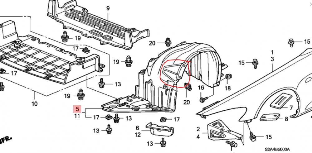

I believe you pop the inner fender (1-2 clips) to change them on the S2000, have you tried that? It's in the manual probably
Or remove the whole fender liner. No need to remove anything, but maybe you knew this...

AHH! did not, but since i was also changing the main beam H1 bulbs, the lights had to come out. Thanks, i will try this ASAP.pasen skrev: ↑21 september 2022, 23:37 I believe you pop the inner fender (1-2 clips) to change them on the S2000, have you tried that? It's in the manual probably
Sorry I cant help with the LED issue tho. Does it matter if you have the fender indicators OEM or LED for the headlight indicators to work?
